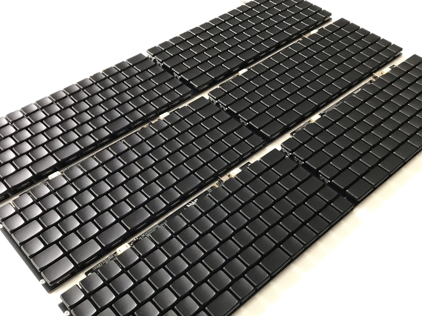

When it became clear near the end of 2020 that things would be delayed by at least 2 months, we jumped at the opportunity to improve an aspect of the laptop that had been a matter of criticism by beta customers:
The standard Kailh Choc keycaps don't have a particularly great feel, mainly because they are perfectly flat. After trying out the MBK concave keycaps, we talked to FKcaps about a collaboration. They were able to manufacture a new version of their caps in record speed that fit our laser engraving approach: a translucent ABS body painted with a thin layer of black PU. Our minimalistic design strategy of using only two different keycaps on the keyboard paid off here by simplifying the mold making process. The result is that the production MNT Reform keyboards look and feel even better than originally planned.

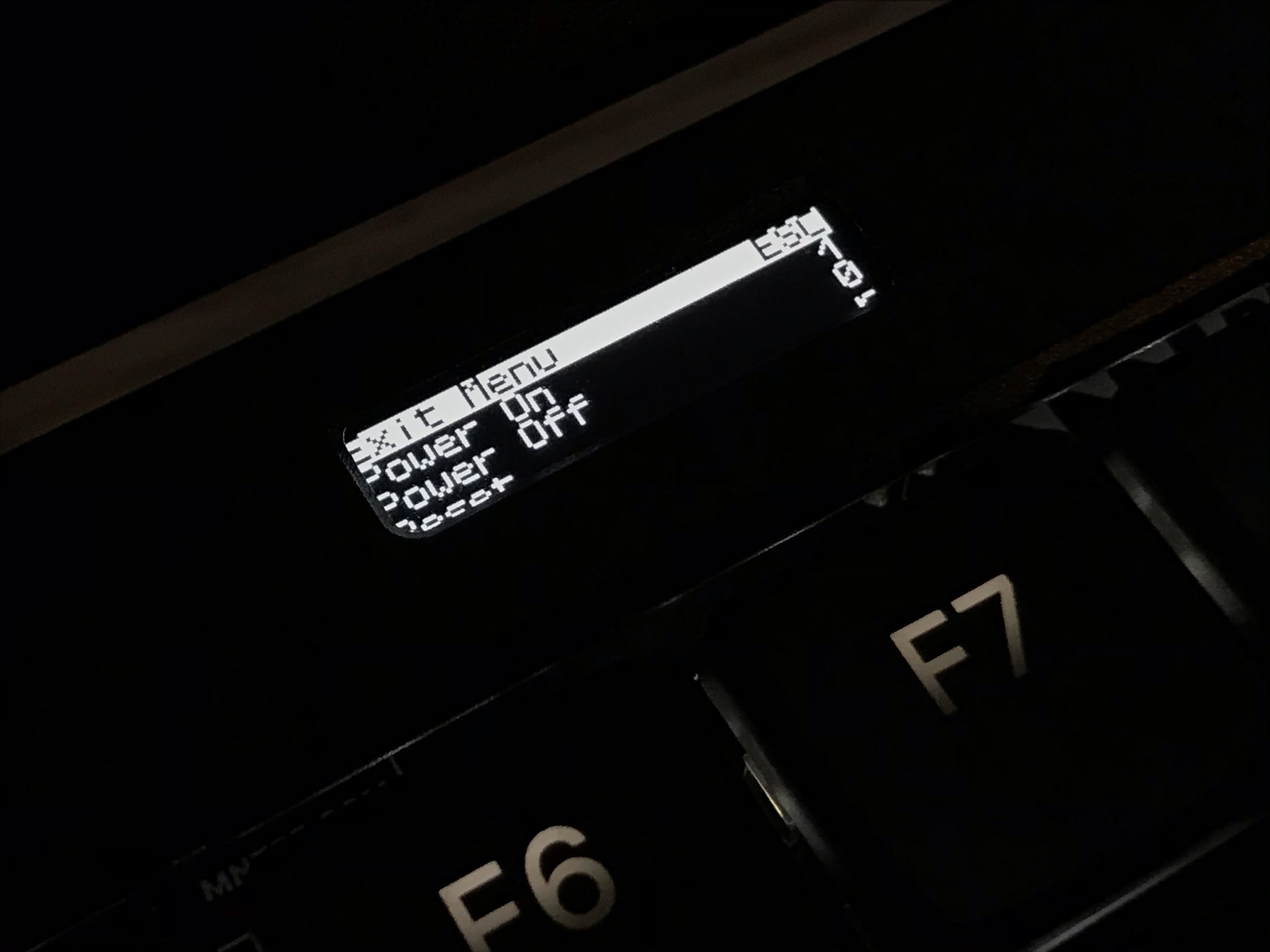

OLED Menu
While writing the handbook I realized that the system controller functions triggered by key combinations should be made more discoverable. I wrote an interactive scrollable menu rendered on the OLED display which lists all functions and their shortcuts, but it also allows you to just select a function and press ENTER to trigger it. You can enter the menu at any time by pressing the Circle key. Among the current functions are "Power On/Off", "Reset", "Battery Status", controlling the keyboard backlight and "Wake" from standby.

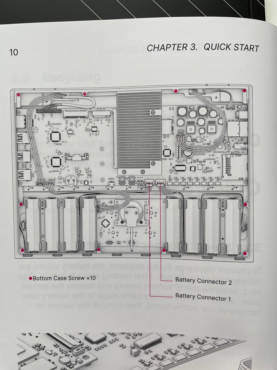

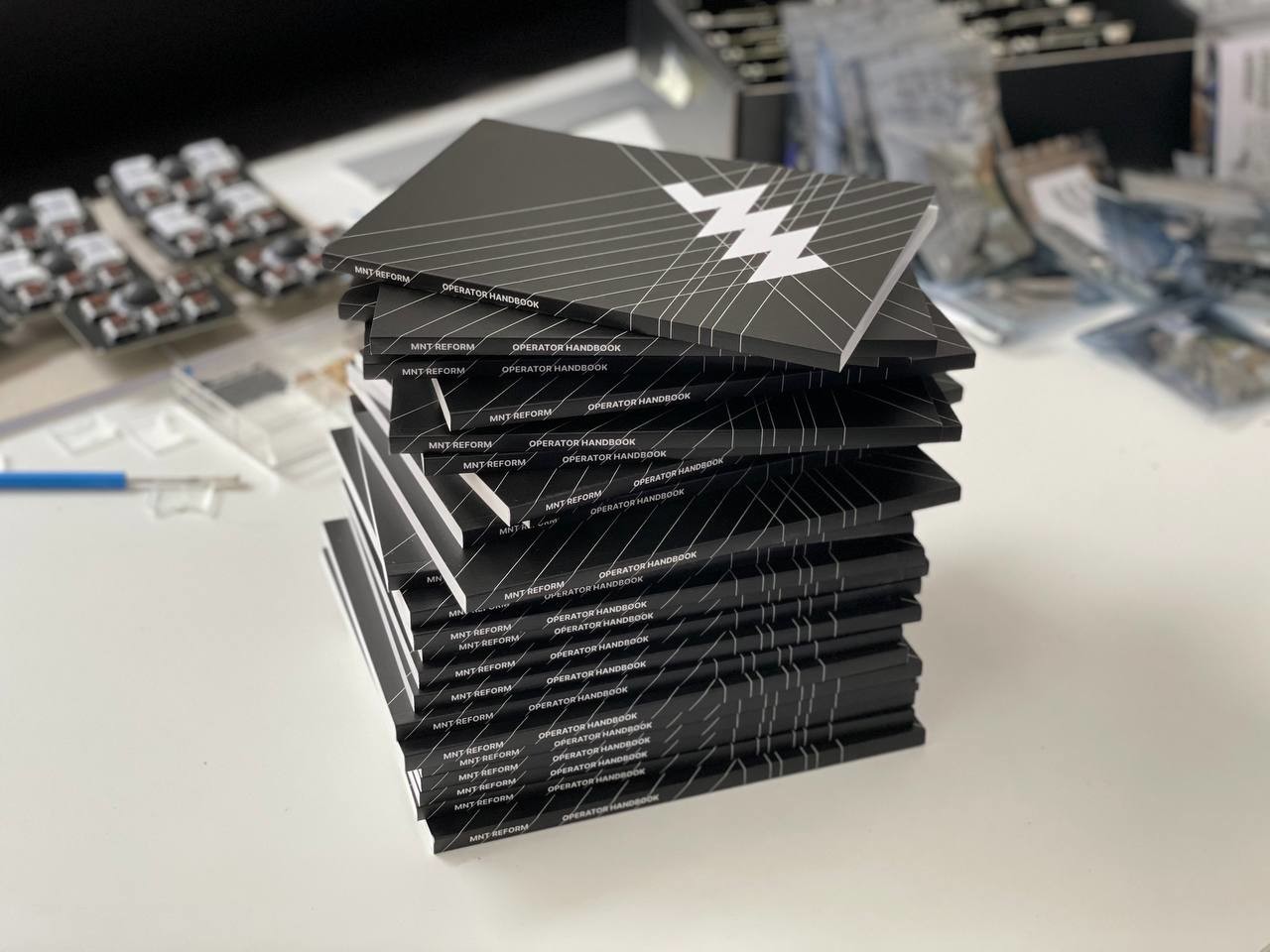

Operator Handbook Completed
Stack of MNT Reform Handbooks
In the first weeks of 2021 I wrote the MNT Reform Operator Handbook with some initial help from Ben Cardinal and later with Brendan Nystedt as my editor. Paul Klingberg contributed a number of crispy illustrations of MNT Reform parts rendered in a line drawing style. 100rabbits contributed the cover design and the design of the online version. Pinguin Druck in Berlin printed the handbook, which ended up being 136 pages in A5 format. All sources for the book can be found in our git repository.
MNT Reform Operator Handbook Content 1 MNT Reform Operator Handbook Content 2

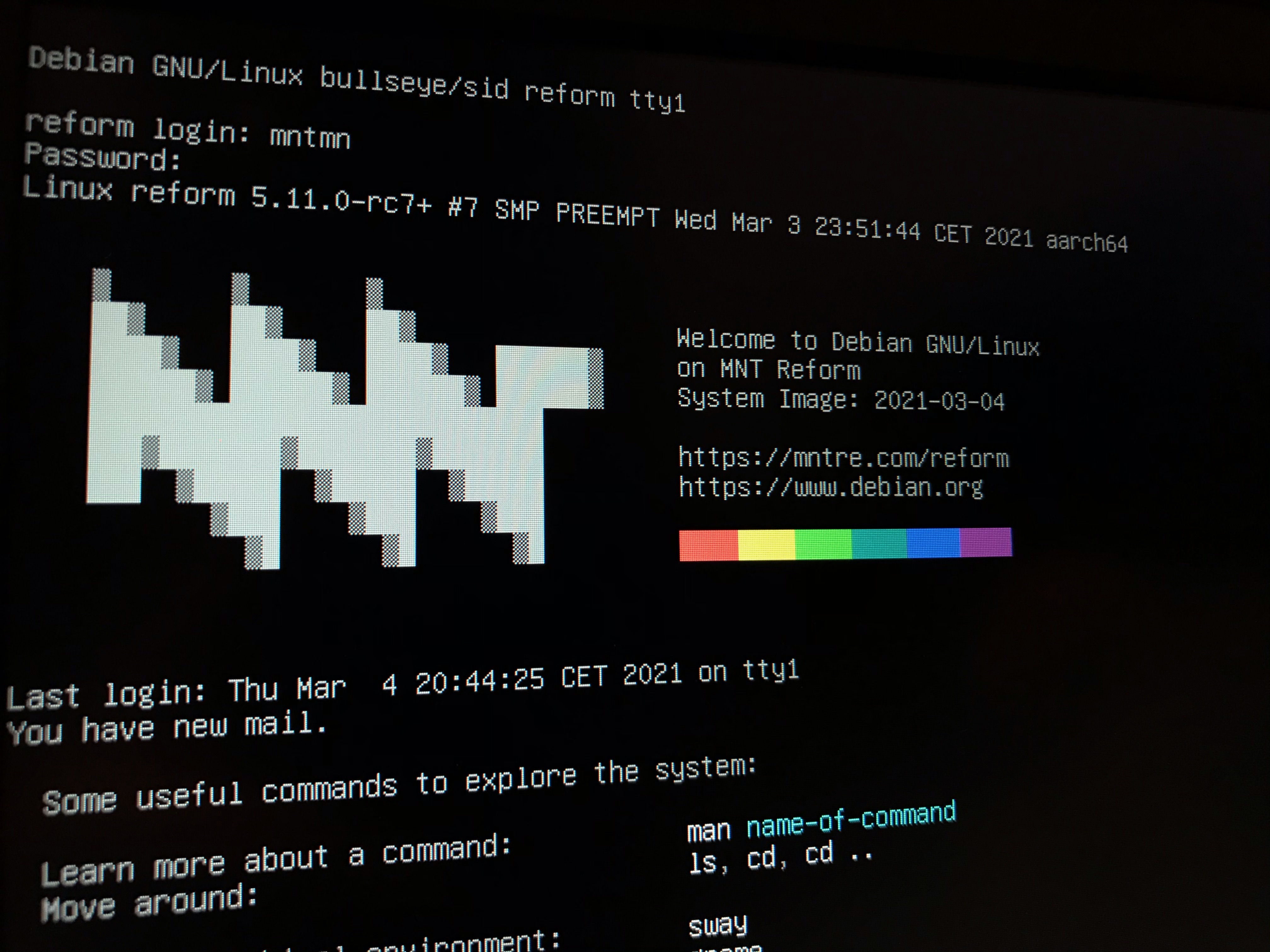

System Image Completed, Rescue System on eMMC Flash
MNT Reform System Image MOTD
Next to managing logistics, I spent most of the last 1-2 weeks completing the system image(s) for MNT Reform, now based on Linux 5.11 and a Debian Sid userland. There have been numerous small tweaks to the system including a third desktop option: WindowMaker running on the Cage single-application compositor (the single application being a fullscreen Xwayland in this case). The reform-windowmaker script demonstrates how to run classic Xorg desktops on a Wayland compositor, as Xorg by itself doesn't currently work reliably on the etnaviv modesetting drivers. Also, running Xorg environments on Wayland gives you tearing-free output as a bonus. If you prefer the native Xorg anyway, you can currently run it on the Linux framebuffer using the fbdev driver, but without hardware acceleration.
Our build script (mkimage.sh) now first builds a smaller version of the full image (without big desktop applications like LibreOffice) called the Rescue System. We install this Rescue System on the 16GB eMMC flash included on the Nitrogen8M processor module. If you ever make your main system unbootable and don't have a second SD card, you can flip the DIP switch on the processor module to boot from eMMC instead. You can even reverse things and move your main OS to eMMC and boot from SD cards in emergency situations. Currently, accessing the switch requires to remove the heatsink from the processor module, though.

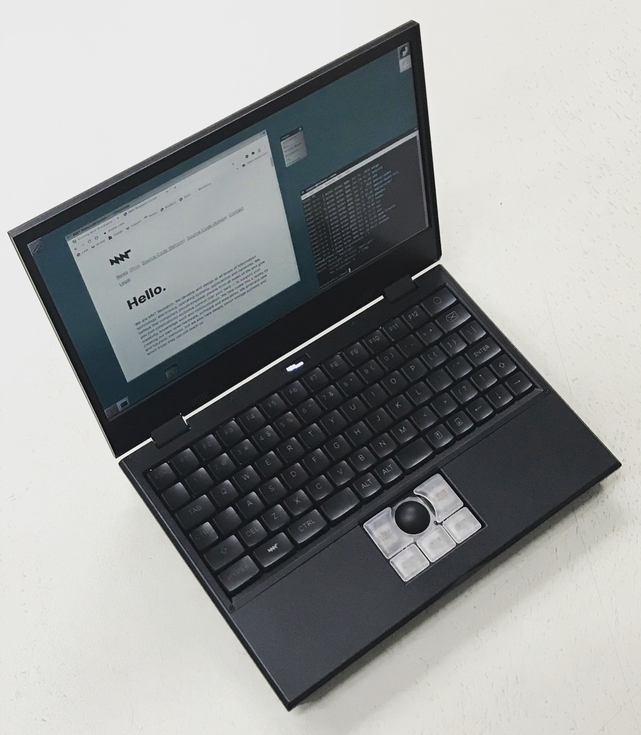

Electronics Stocked, First Production Unit Booted
MNT Reform Production Unit
We have all electronics stocked to build 450 MNT Reforms, except for some of the keyboards: we have 330 in stock and 150 on the way to us. In any case we already have enough circuit boards to fulfill all campaign orders. We also received the first 25 sets of aluminum/acrylic case parts. We discovered minor cosmetic issues on the anodizing of a few of them that are already feedbacked and corrected for the remaining production batches, which are planned to be shipped to us on March 12th.
Nevertheless we have started assembling the first ten production laptops and successfully booted the first one yesterday, which was a bit of a magical moment. While we're still learning how to do the assembly and packaging in the most efficient way possible, our plan is to ramp up to 10 devices per day in the next 2 weeks.
